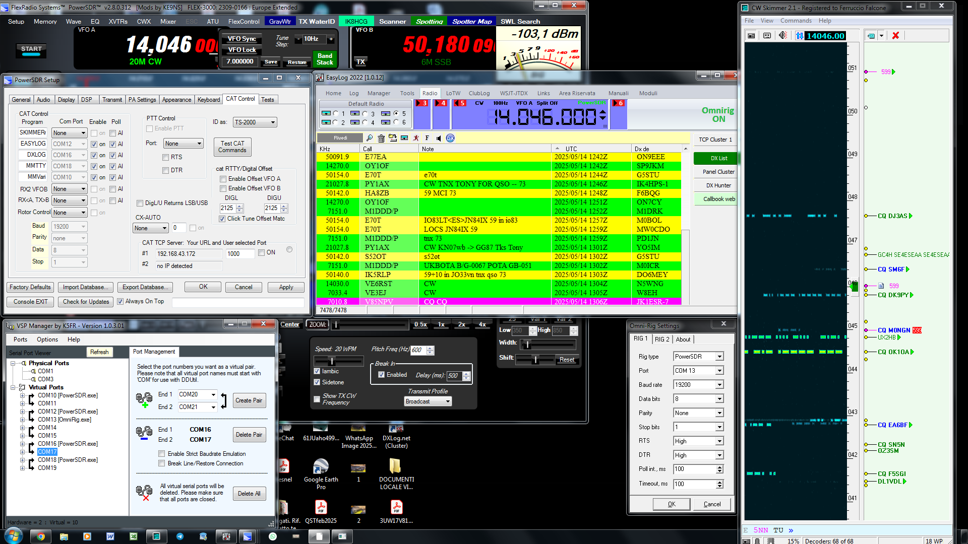

would there be some way to use multiple available Ominirig distinct and separate? I explain I have the station log that uses Ominirig with powersdr, then cw skimmer with Ominirig all assigned with different port with VSP Manager but when they are both open one of the two does not work or works incorrectly and they automatically assign themselves a common port equal

talking to a friend, if each software that manages Omnirig with virtual Cat was given its own .exe destination path?

I found this:
if I disable the function in setup-Cat control- RX A, TX B, Ominirig takes a single virtual Cat in common and everything works regularly without assigning different virtual CATs
