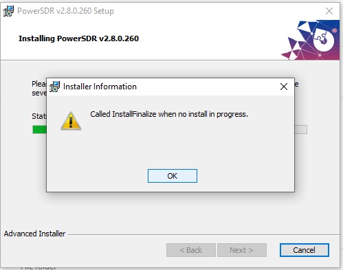

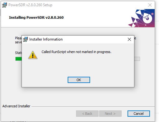

Hi All, I was trying to update on my Win 10 machine at home, The Win 11 machine Updated OK.
I am now wintering in AZ and I cannot update the Win 10 machine. I have captured the screens..see attached.

- PSDR V2.8.0260 Installation Problem 2.jpg (37.44 KiB) Viewed 23103 times
- PSDR V2.8.0260 Installation Problem 1.jpg (36.41 KiB) Viewed 23103 times

I have never encountered that fault before.
if installing .263 doesnt work you may need to uninstall everything and re-install the Full installer first (again) before the .263 incremental.
