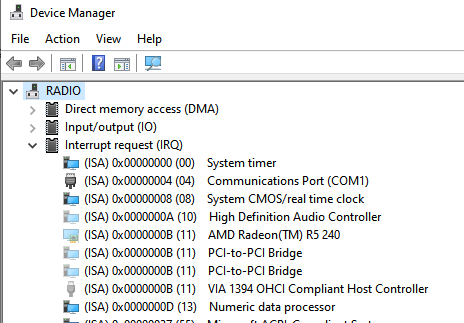

Re: win 11 blue screen when power off powersdr
Hi Darrin
Yes still getting the blue screen. I have removed the video card and moved the fire Wire card over to the spot the video card was in.
here is what I find in Device Manager.
If this helps. I have been running it and it not as bad as it was. I can deal with it now. lot better after I removed the video card.
thanks for all you are doing.
I mite look into going back to windows 7 computer only and have it on my home network only with no updates and do remote in to it from another computer. something new to learn. lol
- this shows the ISA with the VIA 1394 OHCI
- Capture Comtrol Manager.PNG (21.4 KiB) Viewed 41922 times
- this shows the VIC1394 OHCI host controller with the Intel(R) sharing
- Capture 16 IRQs.PNG (9 KiB) Viewed 41922 times
- Posts: 570
Well your down to just 1 IRQ conflict, but you still do have a conflict. You could try the IRQ MSI trick that i found (and reported on my website under the FireWire link). It can be risky so you need to make sure you have a Recovery thumbdrive created before attempting.
If you try Win7 SP1, I would be interested to know if the IRQ conflict clears up (if your using a different hard drive on the same computer)?
