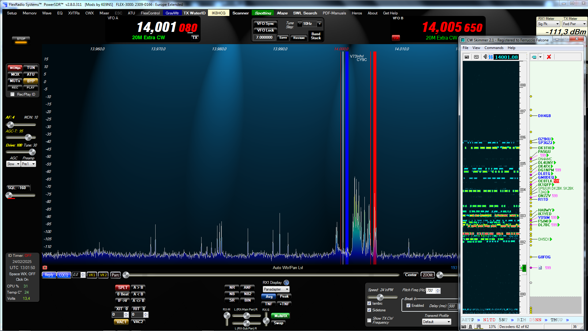

when I use cw skimmer for correspondent hunting in split 599, I set the cw skimmer in the CAT section on powerRX2. everything is ok. the problem is the following:
the DX station that operates, as in the case (VK9XU) at 21.033 split 1-10 up so up till 21.043. the Cwskimmer receives the pileup outside the split range frequency. For example, if a DL responds at 21037, the CW skimmer signals the DL that it has passed the 599 on another frequency shifted by a few khz.
you can check
this is the cw skimmer setting to set vfoB and keep vfoA locked. this way allows you to immediately identify the correspondent when he gives 599 to the right station, but the pileup you get on power sdr, cwskimmer in my case reads it shifted a few kilohertz above so if a station passes 599 to 7010 cw skimmer reads the correspondent a few kilohertz above so if I click on the call that gave the 599 I won't be on the real frequency

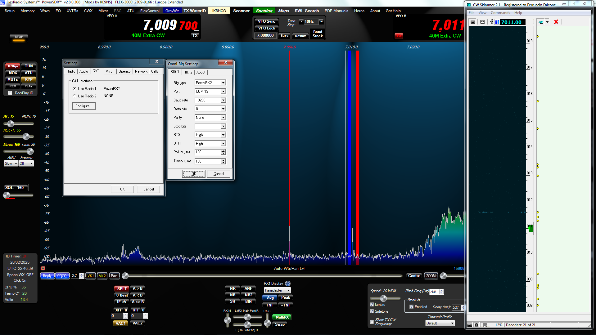

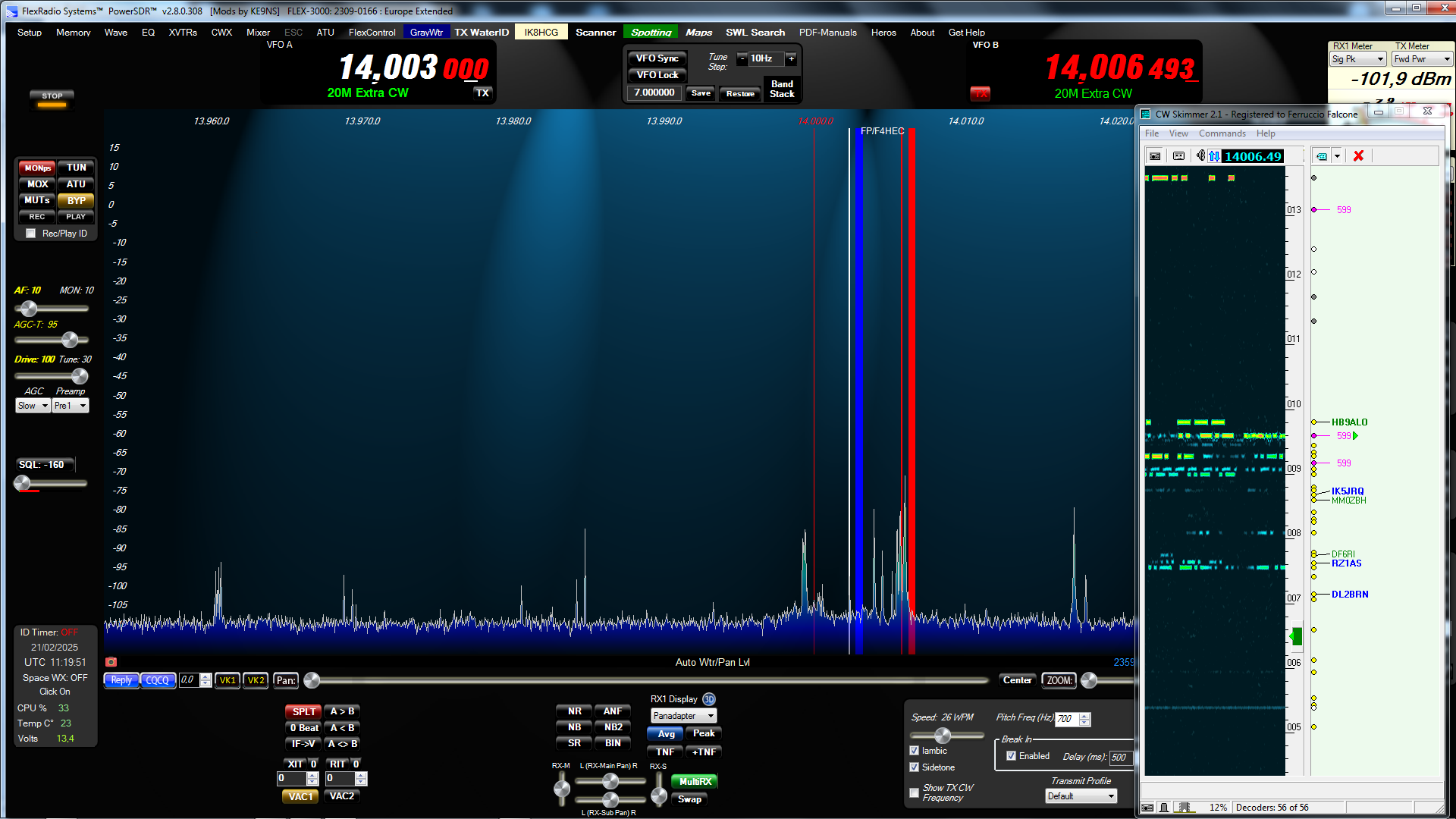

Re: CW skimmer strange with PowerRX2
FP/F4HEX tx 14.003. split till 14.006. Cw skimmer reads pileup from 007 outside of pileup range
- 3.png (529.76 KiB) Viewed 25370 times
"RX2 VFOB" CAT port was designed for RX2 only, it was never intended for being used the first receiver.
CW Skimmer puts the frequency display of VFOB over the IQ visual signals of VAC1 which is tied to VFOA
So what you see in CW skimmer will never match up with the frequency its displaying.
I will add a new VFOB CAT port to allow for SPLIT over CAT

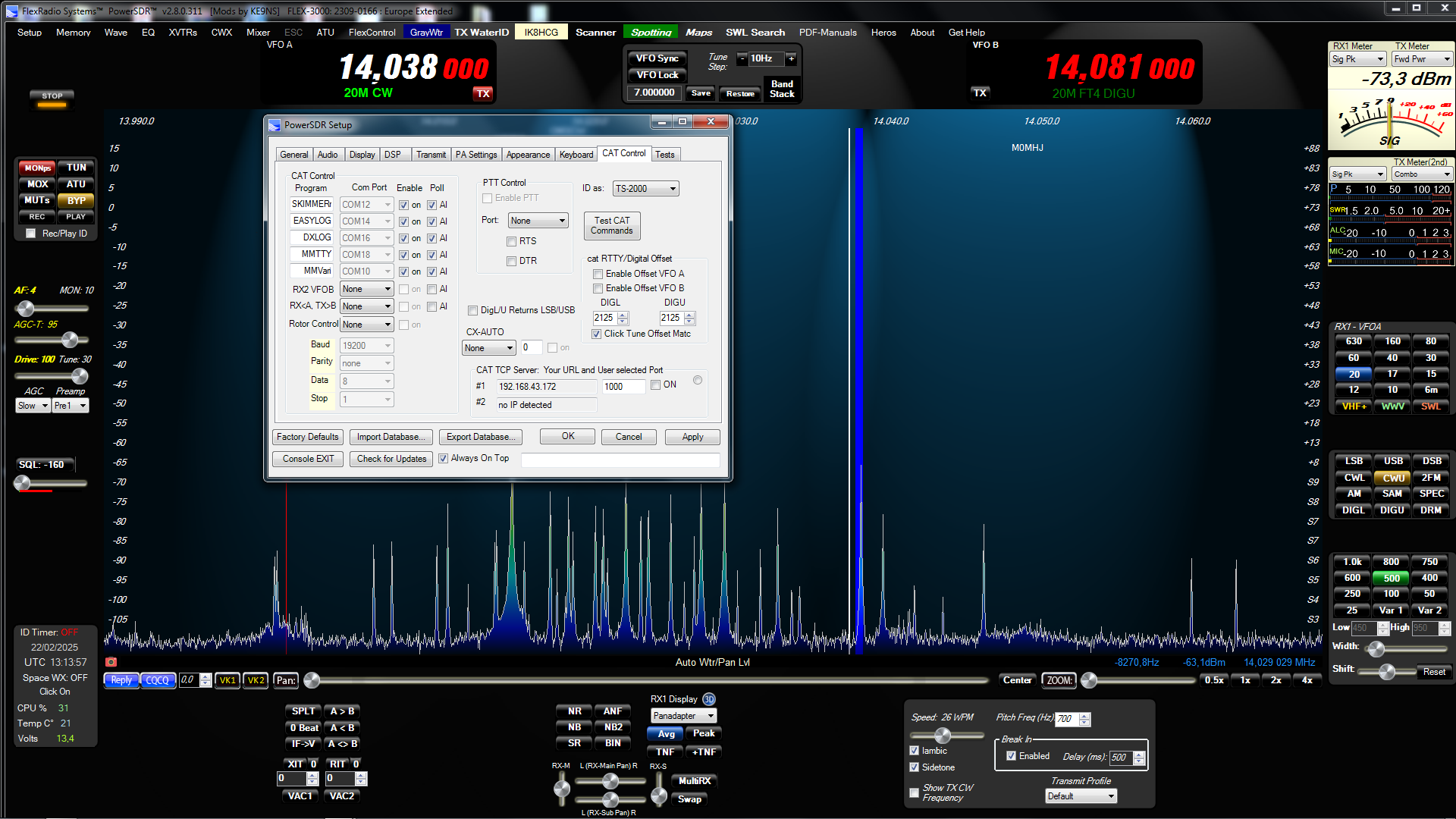

Let's see if I understand. I disable the first field where it says Skimmer com12.
- Field RX2 VFOB (None) Enalbe on.
- RX-A TX-B field insert Com12, Enable on.
Right?
Right?

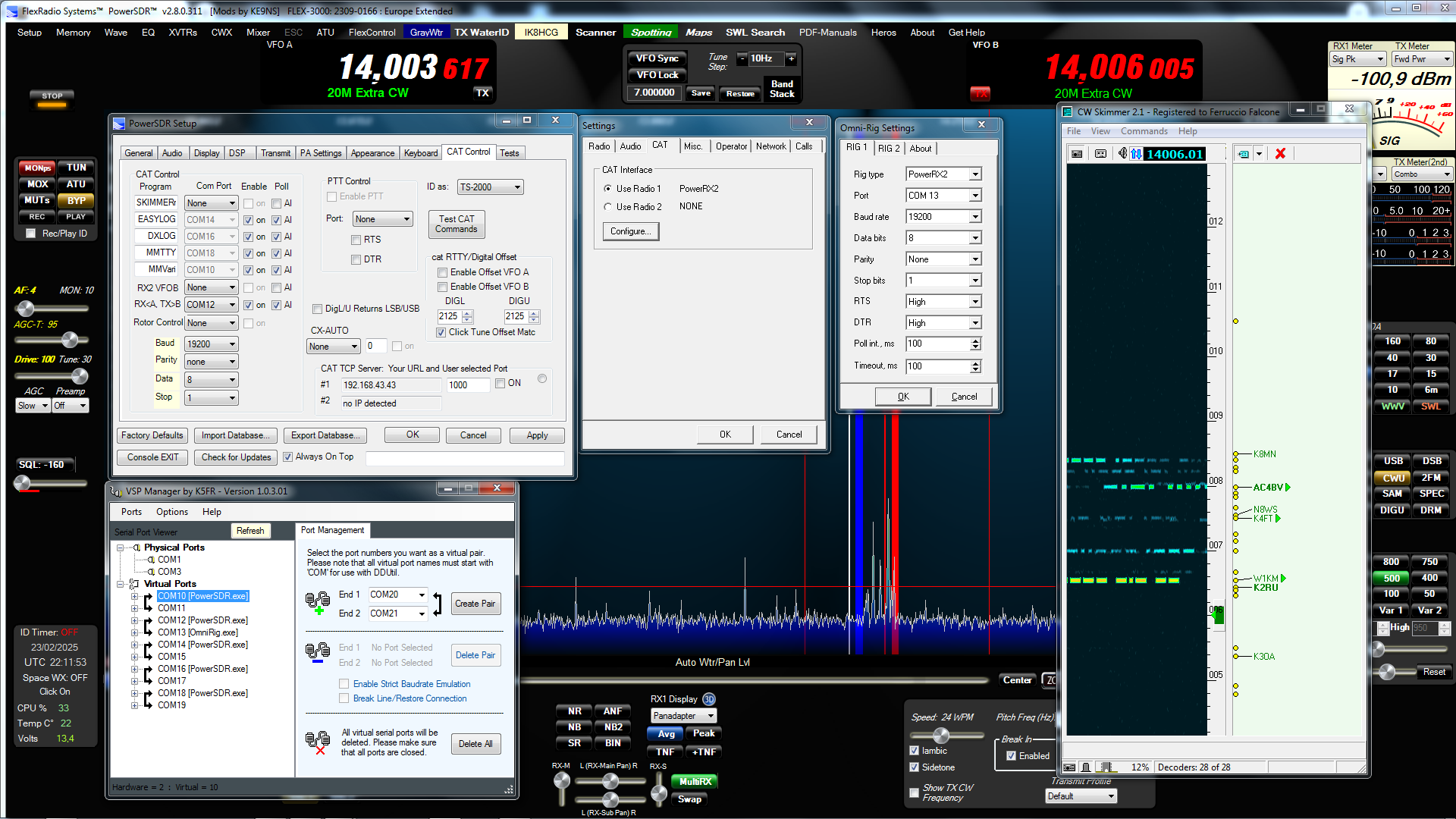

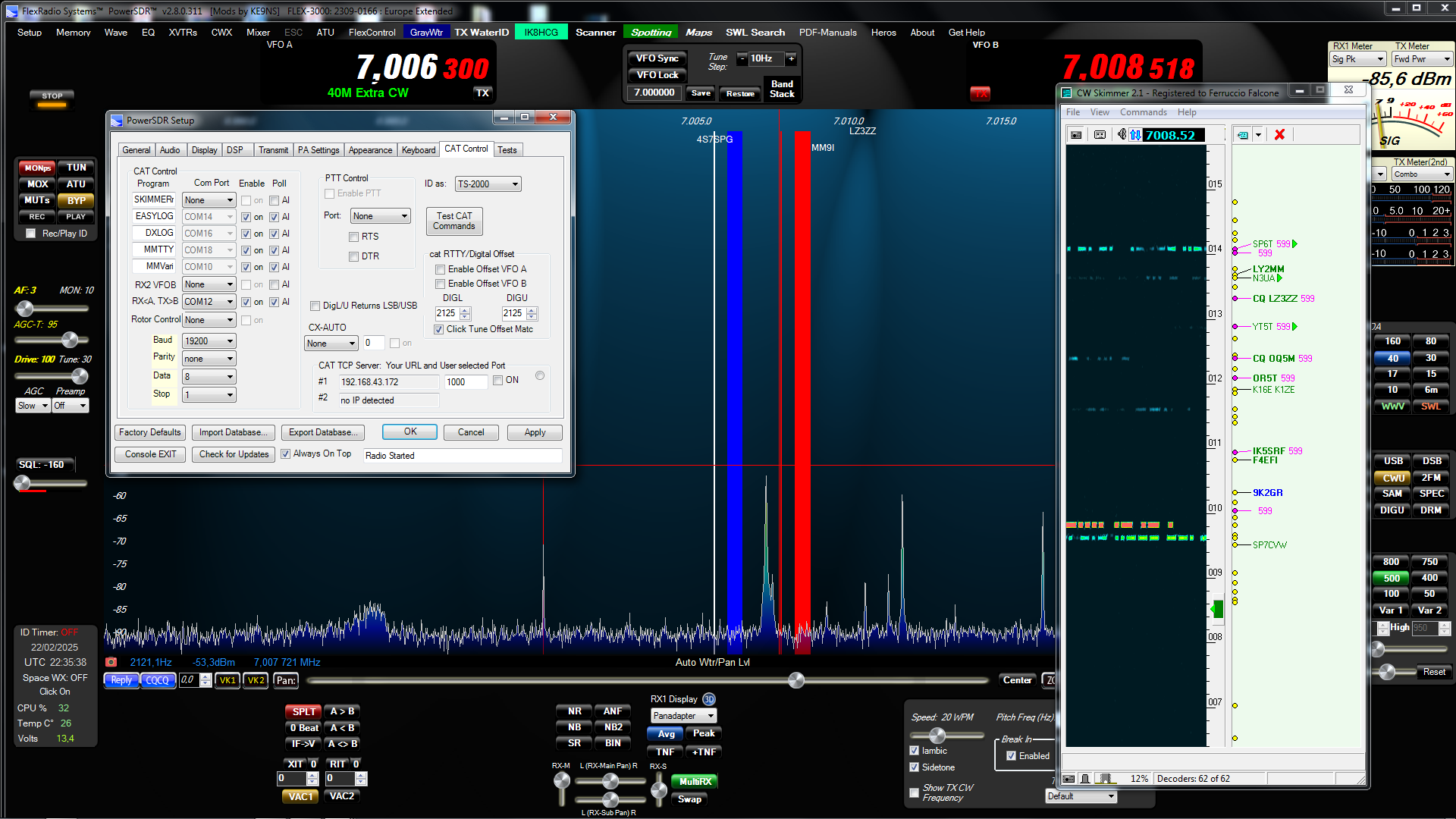

I think the problem persists. cwskimmer decodes out-of-range calls
in the first photo the signal on red is LZ3ZZ and cwskimmer reports it at around 7013.80
- 2.png (503.83 KiB) Viewed 25205 times
- 1.png (515.01 KiB) Viewed 25205 times
Only the "RX2 VFOB" cat port would allow CW Skimmer to display the frequency of VFOB
When you use "RX<A, TX>B" cat port, the Frequency Display on CW Skimmer will only display the frequency of VFOA
Since your CW Skimmer is displaying VFOB frequency, CW Skimmer is not paired with COM12 from your photo?
I would save the settings, shut down, and run PowerSDR again to see if the settings just didnt lock in?
I just confirmed its working correctly but it looks like you need to click the "ON" checkbox 2 times to get it to startup
I will take a look at the code to see why its not automatically starting when checked "ON"?

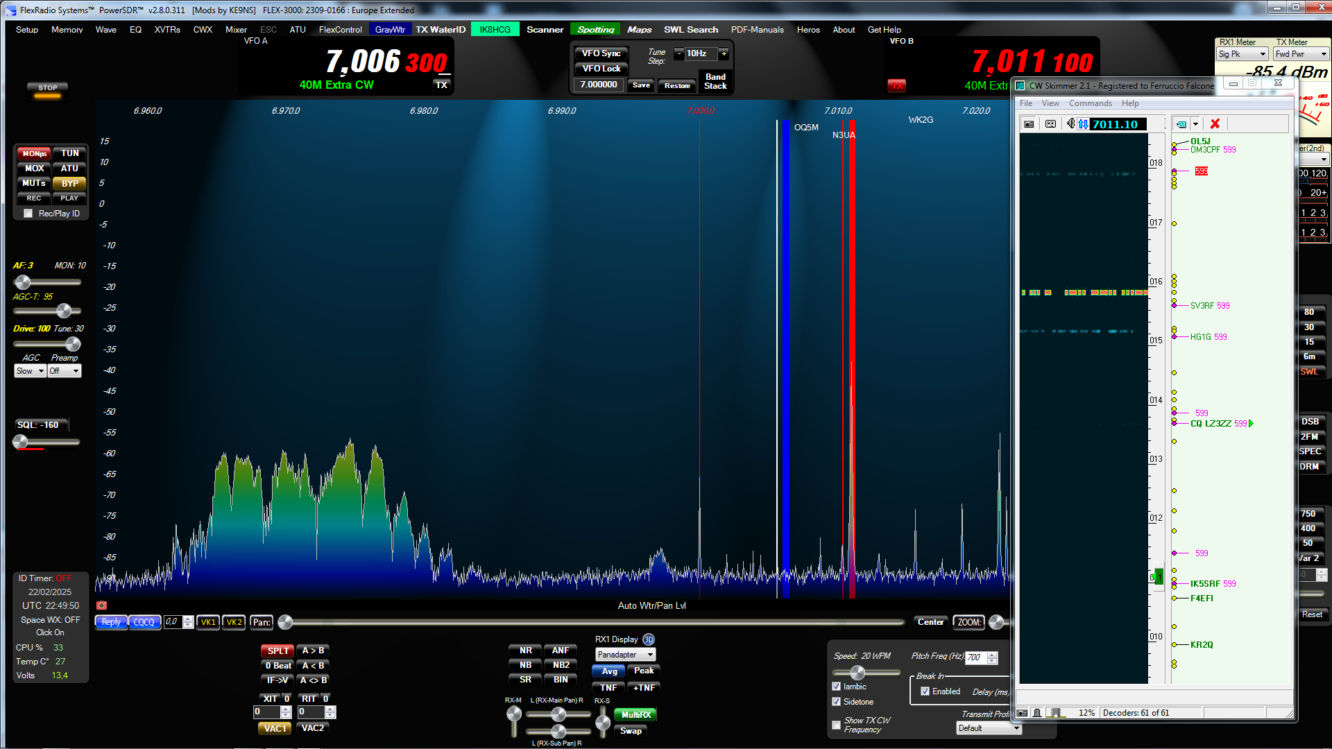

I don't understand where I'm wrong. the cwskimmer pile up reads it out of range.
I ran 0.311 repair twice
- 1.png (546.92 KiB) Viewed 25147 times
- Posts: 570
Re: CW skimmer strange with PowerRX2 Topic is solved
Found your issue!
Your OmniRig is set incorrectly.
You have the Rig Type = PowerRX2
When you mentioned PowerRX2, I had no idea you were talking about "OmniRig"
PowerRX2 is only for the Flex-5000 when using RX2
Set the Rig type to "PowerSDR"
And use "RX<A, TX>B"
And you will now be able to click on a 599 in CW Skimmer and only SPLIT VFOB will move
According to CW Skimmer, you can then hit the "END" key on your keyboard to keep the DX Station always at the bottom of the CW Skimmer display.
