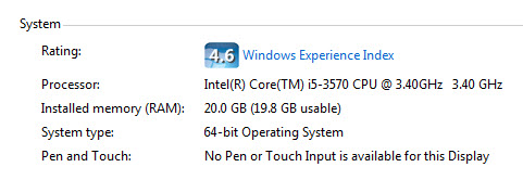

I was running VAC so I removed it and installed VB Cable, seems to be a bit better.
System is shown in attachment. Can't see where to see what the CPU% is.

Re: Audio lag when using FT8
CPU usage is running around 17%

If your running VB-Cable and you have the Sample Rates matched, and you dont see a massive CPU% spike on the FT8 decodes, you should be good on the Virtual audio side.
