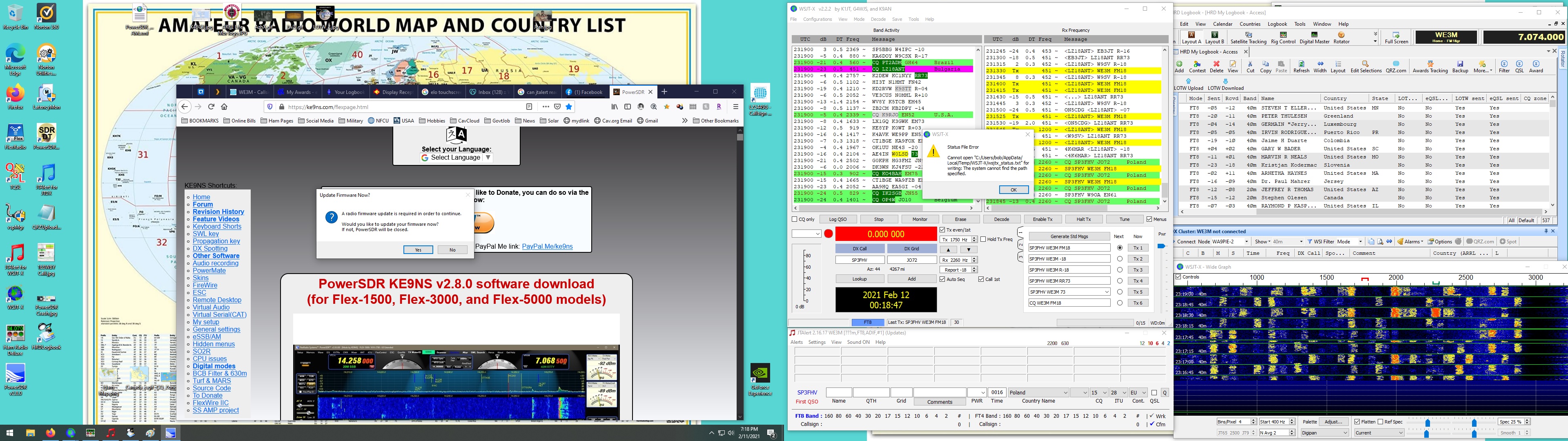

Recently while operating, receiving, I notice the audio cutting in and out and with the start button flashing on and off around 4 times a second. Adds to the excitement of decoding FT-8! It stops after a second or two and acts like nothing happened, but we both know it did. lol.
Every time I stop the radio and take a break, when I come back and start the radio back up I get an Unhandled Exception Error as seen in the attached pic. After clicking continue, I'll get pointer errors and the only way out is to close the program.
PowerSDR Crash.jpg (1.57 MiB) Viewed 18285 times

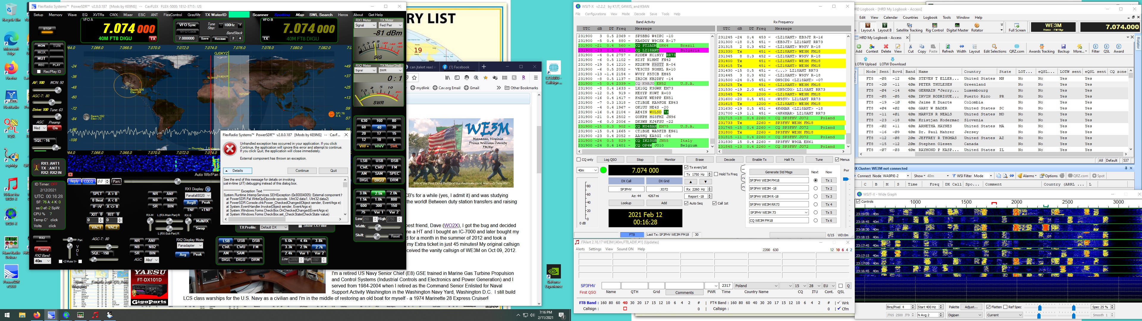

Then when I try to restart PowerSDR I get another strange error saying a firmware update is required as seen in the second screen shot. The only solution is to reboot the whole thing and it works after that. For a while. Sometimes an hour.. sometimes a couple. But it always seems to fail when I just called some DXCC that I need...
PowerSDR Crash 2.jpg (1.36 MiB) Viewed 18285 times
I copied the details of the exception error but lost them when I did the screenshots. I can capture it again as it's sure to happen once or twice more tonight.
