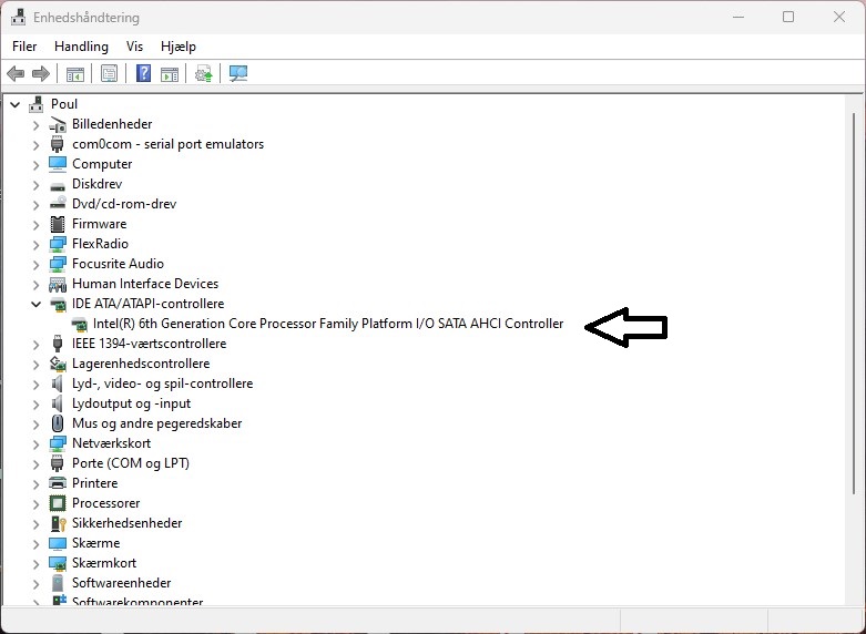

Updade
Find 'dec35c318583' only in 'Power Setings' i regit
change 'Attributes' to 0
Fix High DPC Latency on Windows 11/10 [Solution]
Command Used:
bcdedit /set disabledynamictick yes
Bios
Disable c-states i prossesor
Disabled all efficient cores
Disabled intel Speedstep
In the bios run cpu 1 and 2 fan in Silent mode
Click on Processor.Core E
Set all Active Atom Cores to 1.
New driver IDE ATA/ATAPI-controllere
IDE ATA DRIVER .jpg (82.33 KiB) Viewed 26963 times
MSI MODE.jpg (165.06 KiB) Viewed 26963 times
Intel(R) 6th Generation Core Processor Family Platform I/O SATA AHCI Controller Must be high setting
no pc breakdown more
Now it works

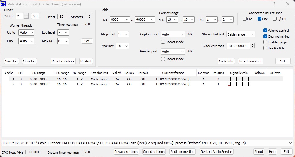

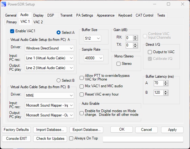

My FT8 vac
dt tid 0.2-0.3 all time
Vitual Audio cable.jpg (138.5 KiB) Viewed 26963 times
